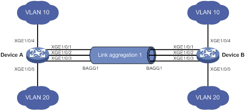

 二层静态聚合配置举例
1. 组网需求
·              Device A与Device B通过各自的二层以太网接口Ten-GigabitEthernet1/0/1~Ten-GigabitEthernet1/0/3相互连接。
·              在Device A和Device B上分别配置二层静态链路聚合组,并实现设备间VLAN 10和VLAN 20分别互通。
2. 组网图
图1-6 二层静态聚合配置组网图
3. 配置步骤
(1)      配置Device A
# 创建VLAN 10,并将端口Ten-GigabitEthernet1/0/4加入到该VLAN中。
<DeviceA> system-view
[DeviceA] vlan 10
[DeviceA-vlan10] port ten-gigabitethernet 1/0/4
[DeviceA-vlan10] quit
# 创建VLAN 20,并将端口Ten-GigabitEthernet1/0/5加入到该VLAN中。
[DeviceA] vlan 20
[DeviceA-vlan20] port ten-gigabitethernet 1/0/5
[DeviceA-vlan20] quit
# 创建二层聚合接口1。
[DeviceA] interface bridge-aggregation 1
[DeviceA-Bridge-Aggregation1] quit
# 分别将端口Ten-GigabitEthernet1/0/1至Ten-GigabitEthernet1/0/3加入到聚合组1中。
[DeviceA] interface ten-gigabitethernet 1/0/1
[DeviceA-Ten-GigabitEthernet1/0/1] port link-aggregation group 1
[DeviceA-Ten-GigabitEthernet1/0/1] quit
[DeviceA] interface ten-gigabitethernet 1/0/2
[DeviceA-Ten-GigabitEthernet1/0/2] port link-aggregation group 1
[DeviceA-Ten-GigabitEthernet1/0/2] quit
[DeviceA] interface ten-gigabitethernet 1/0/3
[DeviceA-Ten-GigabitEthernet1/0/3] port link-aggregation group 1
[DeviceA-Ten-GigabitEthernet1/0/3] quit
# 配置二层聚合接口1为Trunk端口,并允许VLAN 10和20的报文通过。
[DeviceA-Bridge-Aggregation1] port link-type trunk
[DeviceA-Bridge-Aggregation1] port trunk permit vlan 10 20
(2)      配置Device B
Device B的配置与Device A相似,配置过程略。
4. 验证配置
# 查看Device A上所有聚合组的详细信息。
[DeviceA] display link-aggregation verbose
Loadsharing Type: Shar -- Loadsharing, NonS -- Non-Loadsharing
Port Status: S -- Selected, U -- Unselected, I -- Individual
Port: A -- Auto port, M -- Management port, R -- Reference port
Flags:  A -- LACP_Activity, B -- LACP_Timeout, C -- Aggregation,
        G -- Defaulted, H -- Expired
Aggregate Interface: Bridge-Aggregation1
Aggregation Mode: Static
Loadsharing Type: NonS
Management VLANs: None
  Port             Status  Priority Oper-Key
  XGE1/0/1         S       32768    1
  XGE1/0/2         S       32768    1
  XGE1/0/3         S       32768    1
以上信息表明,聚合组1为非负载分担类型的二层静态聚合组,包含有三个选中端口。

[SW1]int Bridge-Aggregation 1   //创建链路聚合组1
[SW1-Bridge-Aggregation1]quit
[SW1]int range gi 1/0/1 to gi 1/0/2
[SW1-if-range]port link-aggregation group 1  //将链路聚合组应用到接口
[SW1-if-range]quit
[SW1]int Bridge-Aggregation 1  //继续配置链路聚合组1
[SW1-Bridge-Aggregation1]port link-type trunk
Configuring GigabitEthernet1/0/1 done.
Configuring GigabitEthernet1/0/2 done.
[SW1-Bridge-Aggregation1]undo port trunk permit vlan 1
[SW1-Bridge-Aggregation1]port trunk permit vlan 10

您好,参考链接
堆叠配置
https://www.h3c.com/cn/d_201806/1089146_30005_0.htm
端口聚合配置
(1)        采用手工汇聚方式:
# 创建手工汇聚组1。
<H3C> system-view
[H3C] link-aggregation group 1 mode manual
# 将以太网端口Ethernet1/0/1至Ethernet1/0/3加入汇聚组1。
[H3C] interface Ethernet1/0/1
[H3C-Ethernet1/0/1] port link-aggregation group 1
[H3C-Ethernet1/0/1] interface Ethernet1/0/2
[H3C-Ethernet1/0/2] port link-aggregation group 1
[H3C-Ethernet1/0/2] interface Ethernet1/0/3
[H3C-Ethernet1/0/3] port link-aggregation group 1
(2)        采用静态LACP汇聚方式:
# 创建静态汇聚组1。
<H3C> system-view
[H3C] link-aggregation group 1 mode static
(3)        采用动态LACP汇聚方式:
# 开启以太网端口Ethernet1/0/1至Ethernet1/0/3的LACP协议。
<H3C> system-view
[H3C-Ethernet1/0/1] lacp enable
[H3C-Ethernet1/0/2] lacp enable
[H3C-Ethernet1/0/3] lacp enable
注意:只有端口的基本配置、速率、双工等参数一致时,上述端口在开启LACP协议之后,才能汇聚到同一个动态汇聚组内,实现端口的负载分担。
