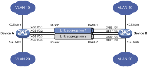

1.9.3  二层聚合负载分担配置举例
1. 组网需求
·     Device A与Device B通过各自的二层以太网接口Ten-GigabitEthernet1/0/1~Ten-GigabitEthernet1/0/4相互连接。
·     在Device A和Device B上分别配置两个二层静态链路聚合组,并使两端的VLAN 10通过二层聚合接口1互通、VLAN 20通过二层聚合接口2互通。
·     通过在聚合组1上按照源MAC地址进行聚合负载分担、在聚合组2上按照目的MAC地址进行聚合负载分担的方式,来实现数据流量在各成员端口间的负载分担。
2. 组网图
图1-7 二层聚合负载分担配置组网图
3. 配置步骤
(1)     配置Device A
创建VLAN 10,并将端口Ten-GigabitEthernet1/0/5加入到该VLAN中。
<DeviceA> system-view
[DeviceA] vlan 10
[DeviceA-vlan10] port ten-gigabitethernet 1/0/5
[DeviceA-vlan10] quit
创建VLAN 20,并将端口Ten-GigabitEthernet1/0/6加入到该VLAN中。
[DeviceA] vlan 20
[DeviceA-vlan20] port ten-gigabitethernet 1/0/6
[DeviceA-vlan20] quit
创建二层聚合接口1,并配置该接口对应的聚合组内按照源MAC地址进行聚合负载分担。
[DeviceA] interface bridge-aggregation 1
[DeviceA-Bridge-Aggregation1] link-aggregation load-sharing mode source-mac
[DeviceA-Bridge-Aggregation1] quit
分别将端口Ten-GigabitEthernet1/0/1Ten-GigabitEthernet1/0/2加入到聚合组1中。
[DeviceA] interface ten-gigabitethernet 1/0/1
[DeviceA-Ten-GigabitEthernet1/0/1] port link-aggregation group 1
[DeviceA-Ten-GigabitEthernet1/0/1] quit
[DeviceA] interface ten-gigabitethernet 1/0/2
[DeviceA-Ten-GigabitEthernet1/0/2] port link-aggregation group 1
[DeviceA-Ten-GigabitEthernet1/0/2] quit
配置二层聚合接口1Trunk端口,并允许VLAN 10的报文通过。
[DeviceA-Bridge-Aggregation1] port link-type trunk
[DeviceA-Bridge-Aggregation1] port trunk permit vlan 10
创建二层聚合接口2,并配置该接口对应的聚合组内按照目的MAC地址进行聚合负载分担。
[DeviceA] interface bridge-aggregation 2
[DeviceA-Bridge-Aggregation2] link-aggregation load-sharing mode destination-mac
[DeviceA-Bridge-Aggregation2] quit
分别将端口Ten-GigabitEthernet1/0/3Ten-GigabitEthernet1/0/4加入到聚合组2中。
[DeviceA] interface ten-gigabitethernet 1/0/3
[DeviceA-Ten-GigabitEthernet1/0/3] port link-aggregation group 2
[DeviceA-Ten-GigabitEthernet1/0/3] quit
[DeviceA] interface ten-gigabitethernet 1/0/4
[DeviceA-Ten-GigabitEthernet1/0/4] port link-aggregation group 2
[DeviceA-Ten-GigabitEthernet1/0/4] quit
配置二层聚合接口2Trunk端口,并允许VLAN 20的报文通过。
[DeviceA-Bridge-Aggregation2] port link-type trunk
[DeviceA-Bridge-Aggregation2] port trunk permit vlan 20
(2)     配置Device B
Device B的配置与Device A相似,配置过程略。
4. 验证配置
查看Device A上所有聚合组的详细信息。
[DeviceA] display link-aggregation verbose
Loadsharing Type: Shar -- Loadsharing, NonS -- Non-Loadsharing
Port Status: S -- Selected, U -- Unselected
             I -- Individual, * -- Management port
Flags:  A -- LACP_Activity, B -- LACP_Timeout, C -- Aggregation,
        G -- Defaulted, H -- Expired
Aggregate Interface: Bridge-Aggregation1
Aggregation Mode: Static
Management VLAN : None
  Port               Status  Priority Oper-Key
  XGE1/0/1           S       32768    1
  XGE1/0/2           S       32768    1
Aggregate Interface: Bridge-Aggregation2
  XGE1/0/3           S       32768    2
  XGE1/0/4           S       32768    2
以上信息表明,聚合组1和聚合组2都是负载分担类型的二层静态聚合组,各包含有两个选中端口。
查看Device A上所有聚合接口所对应聚合组内采用的聚合负载分担类型。
[DeviceA] display link-aggregation load-sharing mode interface
Bridge-Aggregation1 Load-Sharing Mode:
source-mac address
Bridge-Aggregation2 Load-Sharing Mode:
destination-mac address
以上信息表明,二层聚合组1按照报文的源MAC地址进行聚合负载分担,二层聚合组2按照报文的目的MAC地址进行聚合负载分担。
